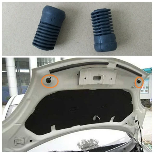

    Heya, I'm having a problem with (forgive me for not knowing the actual word for this) the button under the hood that, when pressed, makes the car honk when you lock it. My car only beeps when I unlock it, but there isn't a honk when I lock it. I noticed that there's a little button in the hood, and a knob on the lid of the hood that when closed, pushes down on the button, which lets the car honk when locked. However, it's not pushing down hard enough, so my car never honks. When I push down on the closed hood lid in that area, it'll honk, but it won't when I let go. What can I do to make sure the button is being pressed down on? I figured if I put some 3m foam tape it would push, but if there's a better alternative, ...

    hi, there are 2 hood rubber stopper from front part of the hood. if you rotate these small adjustment stopper, the hood can close and fit in fully.

    Not only adjustment stopper but also rust at the lock cylinder can cause this kind of problem.
    You should use a rust cleaner to close and fit in fully.

    trigger key can be disabled as a workaround...
